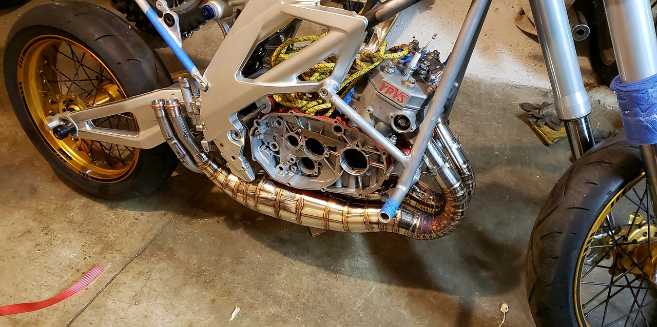

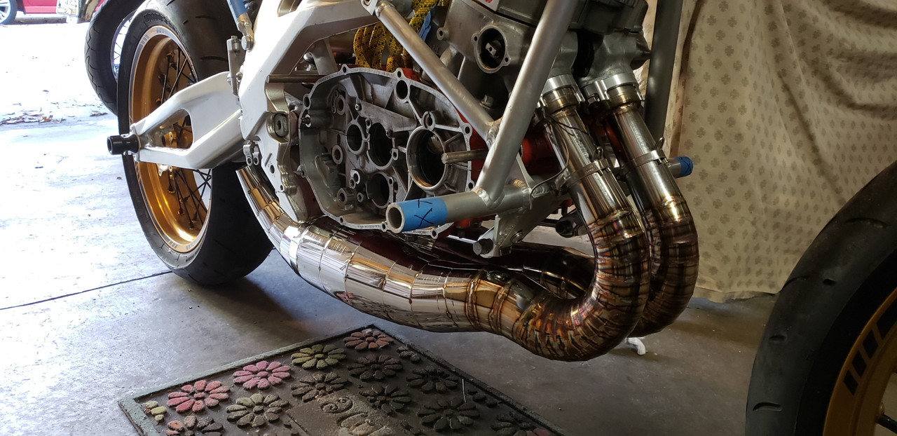

Nope! Those "X"s on the crossbar show how much to chop off. I'll be installing custom sliders on the bar ends. Didn't want to chop before the pipes are done. The blue tape starts at the outside of the side covers. The covers stick out the same amount, just have more bar on one side to chop off.

Pipes are growing fast.

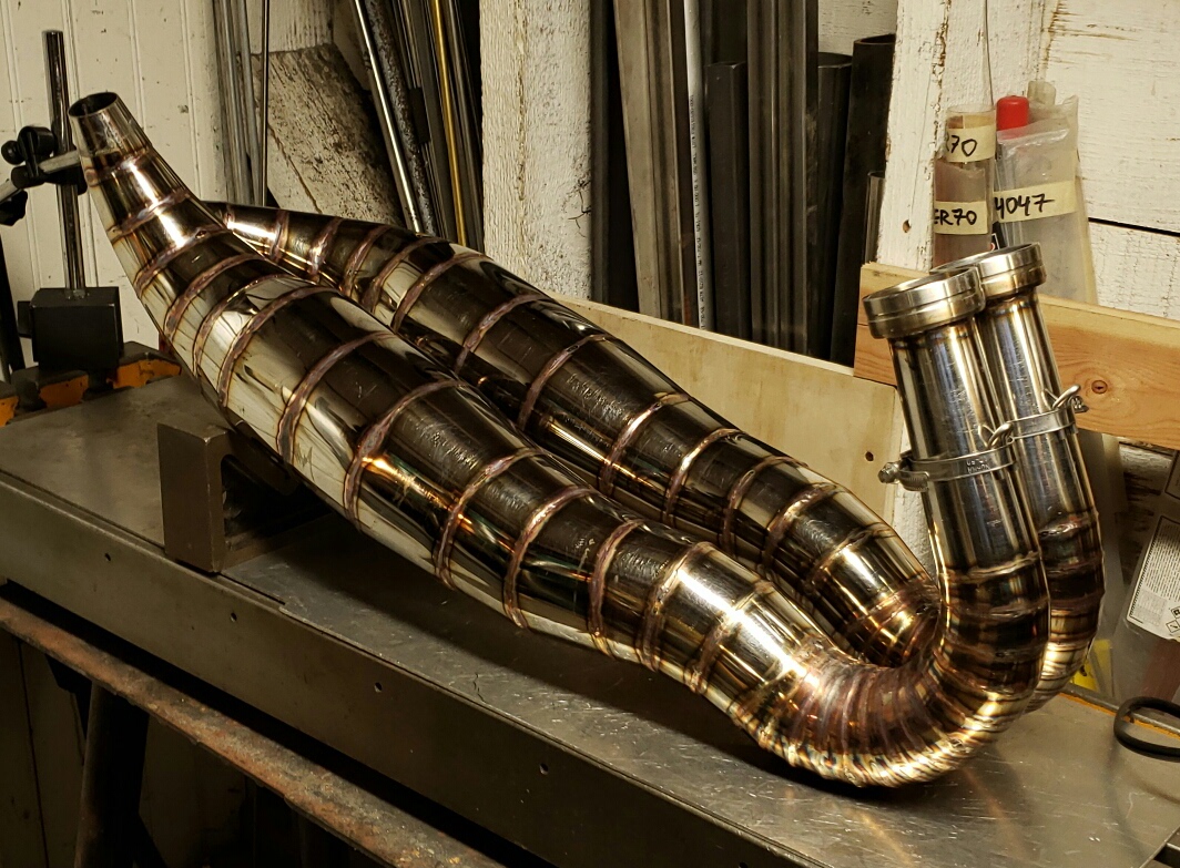

Pipes are getting close to finished.
Not sure if we'll have time to get the billet spring hooks done. Still hopeful.

#1059 Post by Smoker » Wed Jan 02, 2019 8:29 pm
Trying to get these finished.
Pipe construction will probably be done this weekend.

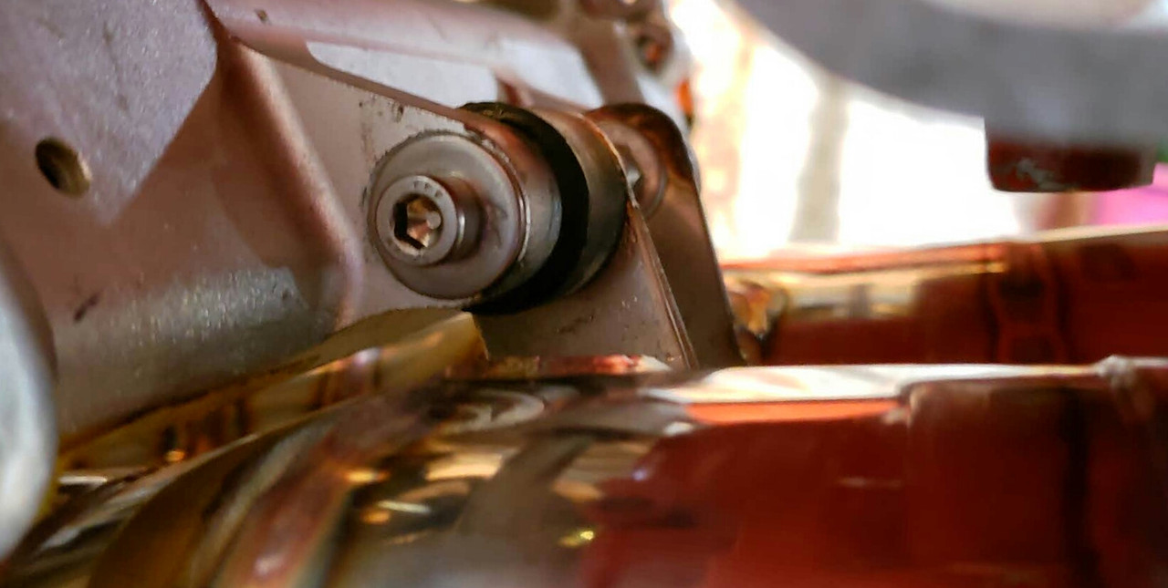

Mason Cantar used this tiny cutter for the spring hook cutouts.
"Ran this little guy at 7500rpm and 6.5 IPM. Easy peasy, ran like butter."
One of the best machinist/welders I've met. Just have to wait until the machines are open to get my stuff done. Takes 3 operations in the CNC machine, plus some manual cutting. If things go well, I'd like to get 24 more of these made out of titanium, with different bottom radii. Kind of skeptical that's going to happen. :smt037

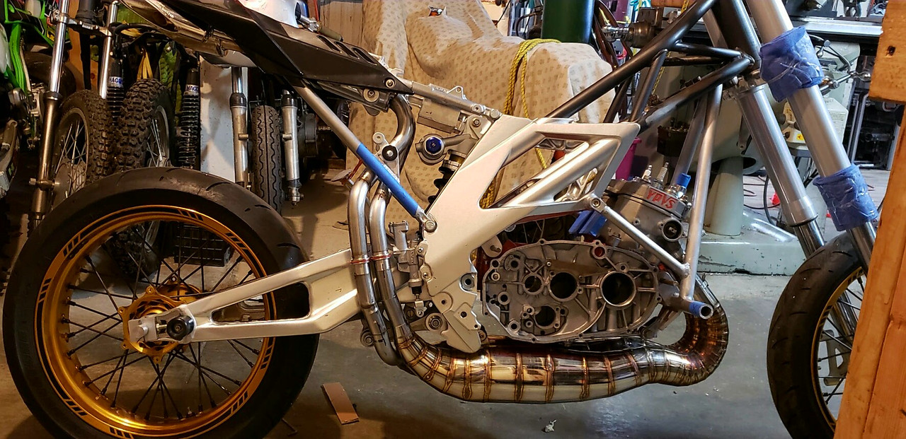

#1062 Post by Smoker » Mon Jan 07, 2019 1:54 am

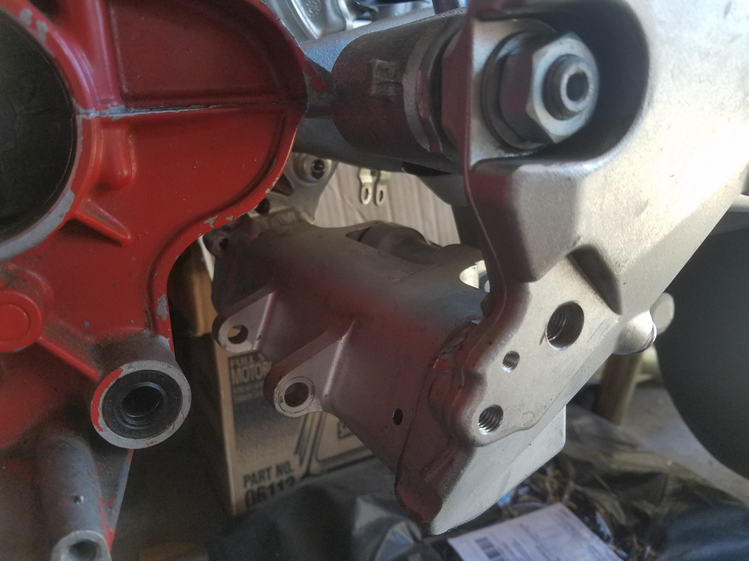

The SXV frame has nice mounts in the perfect place for downpipes.
Almost used these for the engine torque bars. Glad I ran torque bars to the cradle, the way Yamaha designed it.
Asked Jeff to rubber mount the pipes. I also rubber mounted the stingers and tips.
Frame clearance is nice and tight.
I'll add the usual hardware, and maybe some custom rubber cushions.

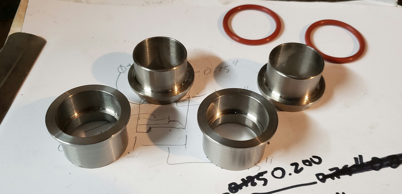

#1063 Post by Smoker » Tue Jan 08, 2019 4:47 am
Stinger couplings are cut.
Need to get thicker o-rings.

#1064 Post by Smoker » Sat Jan 12, 2019 9:52 pm
Pipes are looking serious.
Guess I need some nice tips to fit onto the lower couplings. Then there'll be a nice option for open pipe mayhem. :smt003

Getting there.
Upper part of the pipes will be covered by the lower side panel. Never seen this panel in white. I think this one is painted. Will try to get it in white to match the other plastic.
Rear suspension compressed.
Waiting on the machined spring hooks.
