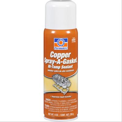

If the gasket has not been heated I reuse them. I've even reused old gaskets by using cleaning surfaces and gasket and applying Permatex 80697 Copper Spray-A-Gasket. If you choose to do that your on your own I disavow any poor results. However it did work for me for thousands of miles on my RZ350 with a used OEM gasket.
