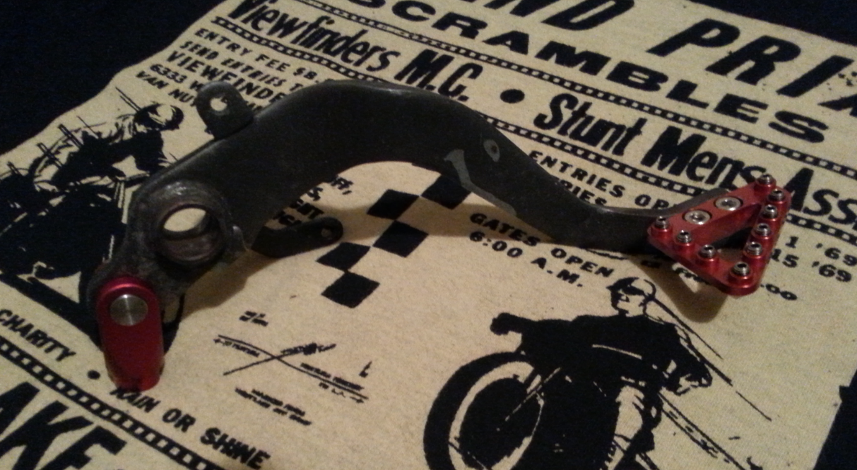

Bald Anthony wrote:
Thanks for the info. Do you have pics of what you did with the brake side?
Added a modern aluminum tip and clevis. Powdercoated the brake arm. Same treatment on the bracket.
