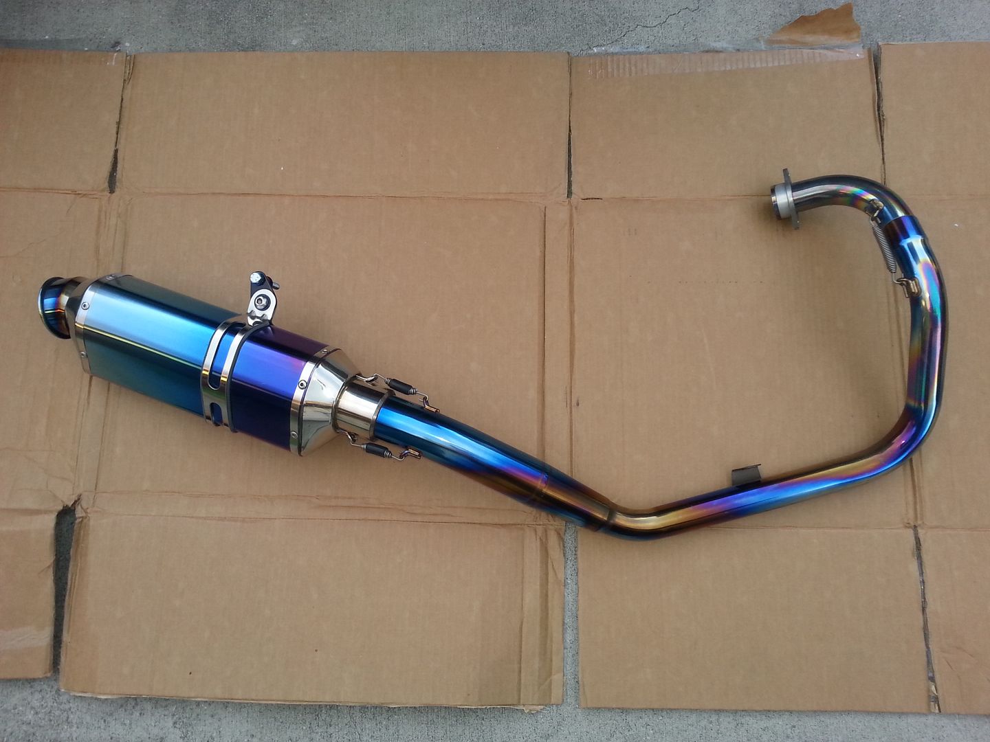

This is my 2nd BEET pipe, and I would buy another:
Don't know about that individual seller.
